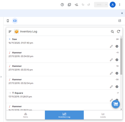

For this option you will simply need to target your Update Log View to the Inventory List View and set the Summary Column to Quantity. This will ensure that every time the inventory item is updated it will show the record from this table. See the images below for more information.
Hope this helps. Let me know if you have any questions about these setups.
