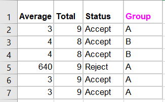

My question is how to auto update the Row2 and Row6 data at “Average” column data to 3 when after i add new row data?
Bellow is the preferable data in table.
0 7 2,887

Could you explain why it is that only row 3 average changes?
Just to get a better idea of a formula.
Could you explain how it works?
Hi Jonthan,…
The Average value is tight with 2 condition.
1- status must be Accept
2- must with same Group
So, the match the condition for GroupA only Row2, Row6 and Row7(new row) are same and for GroupB only Row3, and Row4 are same .
When after the condition are match the new average value will ready to update in by using this formula [Total]/[number of matching row]

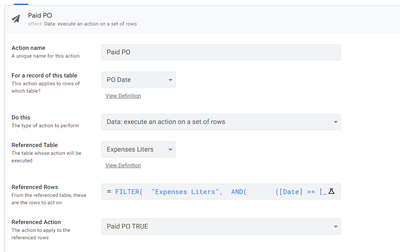

I have tried to update all the rows based on the date on another table. No error but my app froze. can you please help?
I Require to put "TRUE" on the rows that are included in my criteria.
this is the expression I have used to update the rows:
Referenced Rows: FILTER(
"Expenses Liters",
AND(
([Date] >= [_THISROW].[PO Start Date]),
([Date] < [_THISROW].[PO End Date])
Please start a new topic for your question.
