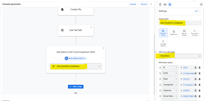

My update action to the Truck inspection sheet , is set through an action attached to my bot of checklist generation as follows:
and truck status is set by [Action] column .Now ,where shall I add my update automation to my truck status whenever [Action] changes?
Thank you. The action in the bot that you have shown seems to be "adding" a new record. You also seem to be setting the [Truck Status] column through the [Action] column. So you may not be able to track a change in the [Action] column in the "Add" action itself. "Truck inspections 2024 " sheet through changes in the "Checklist" tables.
In the previous description you mentioned you are changing the "Truck inspections 2024 " sheet through changes in "Checklist" table. However in the screenshots share, you seem to be adding a row to the "Checklist" table only. Could you clarify?

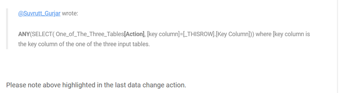

@Suvrutt_Gurjar wrote:
ANY(SELECT( One_of_The_Three_Tables[Action], [key column]=[_THISROW].[Key Column])) where [key column is the key column of the one of the three input tables.
Please note above highlighted in the last data change action.

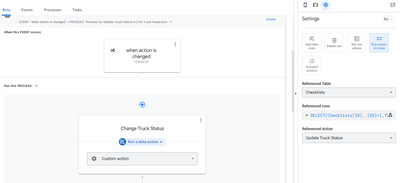

So my update action will look like that:
and referenced rows like that:

I tested it ,but still no change in truck status column in checklists combined table
Yes, the actions look good.
The reference rows action needs to have a list of key columns.
I even changed my reference rows to :SELECT(Checklists[Truck Status], [ID]=[_THISROW].[ID]) but does not work
Reference rows only work with key columns.
Please see in test pane what the expression is returning.
