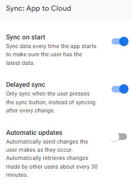

Here are my Offline/Sync toggles:
It works when I'm online, albeit slowly, but offline the properties don't change to active. I thought actions should still work locally without having to sync. I'm wondering, what features of AppSheet are available offline? I could change to a bot... does that work better offline?

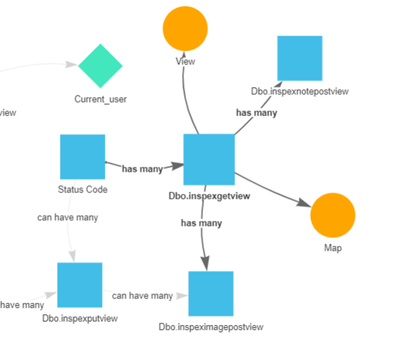

I got rid of the virtual column I was using, but I still have relations (represented by Ref_Rows VCs) do those also not work offline??
Here's where I'm at now:

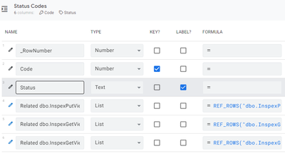

I'm updating the Status in db.InspexPutView as an INT. That references StatusCodes to get (1: Requested, 2:Active, 3:Complete). Then I'm displaying the text on the dbo.InspexGetView.
Ref from GetView to PutView:
PutView Columns:
Status Code Columns:
I don't know what part of it doesn't work offline... Do references not work at all because they are in Virtual Columns?
