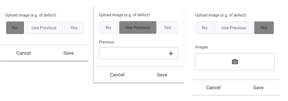

hey, thanks for the advice, and apologies if my description wasn’t clear. Essentially, when highlighting a defect I want the user to be able to choose to add a photo which is stored with that record, viewable by others. However, if the defect has already been identified/photographed then I’d rather they choose form the existing photos, rather than fill up my S3 storage.
I was looking at it too simply, trying to do with one or two objects/columns, so I changed that. Following your advice, my data model now includes the following 4 objects:
  1. User selection ‘Upload image’ ‘buttons’ [type: text, with list]
  2. ‘Images’ object for photo upload [type: image]
  3. Use ‘previous’ [type: enum, from the list of available photos referenced in the table]
  4. Chosen picture [if statement of the above two chosen based on the selection of the Upload Image button, as shown below]
item 1 is always shown, 2 and 3 are conditionally shown based on item 1, while item 4 is hidden [and item 4 represented the aggregated output, used elsewhere]

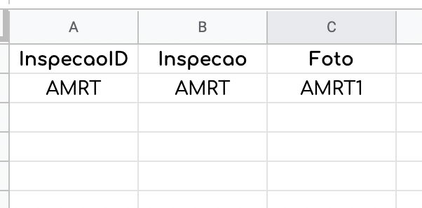

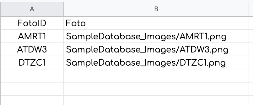

Hi, my last trial on this !
Two tables:
Defects
Fotos
Defects[Foto] is a Ref from Fotos[FotoID] = must have same value.
On table Defects it looks like this
On table Fotos it looks like this

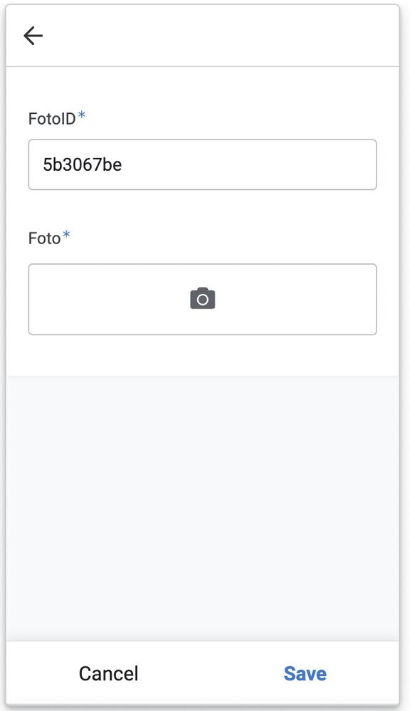

The Defects Form
When clicking on Foto, User can choose existing one or creating a new.
This happens thanks to Ref.
Make column [Foto] not required so if user doesn’t want, he won’t add a picture.
You won’t need column Yes, Choose Previous, No.
If you click in New , you will be redirected to the form of the table Fotos.
Hope it helps!
thanks a lot. I was actually unaware of this ‘ref’ option, so I’ve definitely learned something new here. I like that, and it works. thanks so much
