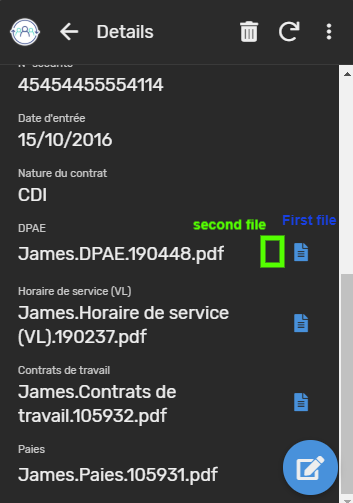

i have a row where i upload pdf , it look like this
but when i use the same row i upload the new file but doesnโ€™t display the old one.
Can you tell me how to display all attached files using the same row please.
I believe I couldnโ€™t be able to grasp your idea here. You want that when you edit a certain record to upload a new file to a certain column, do you want that the existing file record in that column shall be empty? Or what?
i want upload files on an existing record and display both fileslike here
Unfortunately you canโ€™t have such a thing in your detail view
