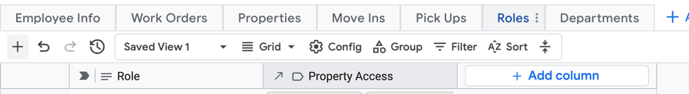

Although the names of the departments and roles share a name, they are not the same. For example, our CEO and CFO both work in the Admin department but the role of the CEO is Admin. The role of the CFO is Admin User. The Admin role gives access to all properties which only applies to that particular role. The Admin User role only gives access to the Admin Office property. I went ahead and just made the roles singular for simplicity's sake. Therefore, each employee only has one role. The "Role" column in the "Employee Info" table is a reference column to the "Roles" table. The "Roles" table has an "Associated Properties" column that is an EnumList ref column. That column references the "Properties" table that contains the addresses. Hopefully, that helps!

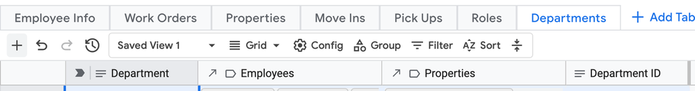

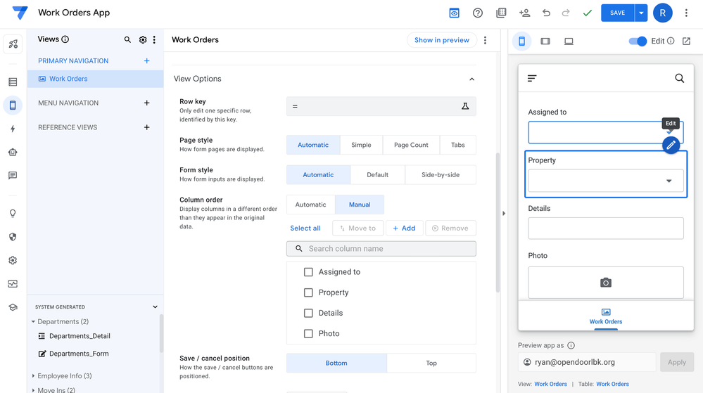

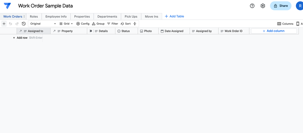

For what it is worth, I have taken a lot of screenshots and even created sample data that uses the same columns/structures/relationships as my actual data, just with fake names/addresses/etc. Hopefully this helps. I did restructured my data a tad to hopefully simplify things from the screenshots I provided earlier.This would be my "parent" table as all the data is funneled to my work orders table.This would be my "parent" table as all the data is funneled to my work orders table."Role" table"Role" table"Employee Info" table"Employee Info" table"Properties" table"Properties" table"Departments" table"Departments" tableWhat I am seeing on the app editor side of things. This is where I want the list of properties to be limited to the user's role.What I am seeing on the app editor side of things. This is where I want the list of properties to be limited to the user's role.In case this view is helpful...In case this view is helpful...

I can tell we are SUPER close! Thank you again for your help! That got us most of the way there. The only issue now is that it is showing the Row ID instead of the actual address. It also has a yellow warning sign beside it? Would that just be the Delta Sync thing because of the security filter?Screenshot 2024-09-16 at 3.35.21โ€ฏPM.png
Typically the exclamation triangle means that there are returned values that are not part of the records the application has access to. So in this case that might actually be unwanted.
In your database table you have the property address as the label column, but how about in the application itself?
Quick follow up on this. This could also be an error because your [Row ID] column is not set as the key column in the application itself. If you are using the other ID columns that you created in the table then you would need to set the suggested values to "Properties[Property ID]"
You are awesome! That worked! Thank you so so much! That ended a month long battle for me!
