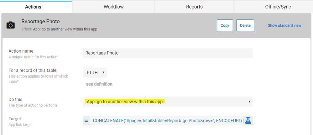

I will try to explain how now i manage my form :
Create a slice for every โ€œSectionโ€ you want
  1. In every slice, you need to add a common column [ usually your unique rรฉf ]
    Letโ€™s say you want to create an app for a building inspection, it will be the column having the Name Building
Create a view for every Section from the slice you created [ not mandatory, but i do like to edit the detail of the view by using quick edit column, like that no sync needed for the user to โ€œtransfer dataโ€]
When all your views are finished, made them as a rรฉf view
Now create an โ€œApp: go to another view within this appโ€ action for every section view you just created :
For the target formula of the action :
CONCATENATE("#page=here the type of view you want to go, detail, form etcโ€ฆ&table= here the view name&row=", ENCODEURL([here your unique column]) )
Set them as Display prominently and choose an icon that reflects the section
Now you just need to add those actions in your main slice and those will be available in your main view.
You now have a kind of a main view with icon to go to every section,
With the same principle, you can create sub-section too
Donโ€™t know if itโ€™s clear,
