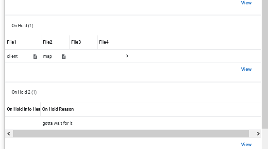

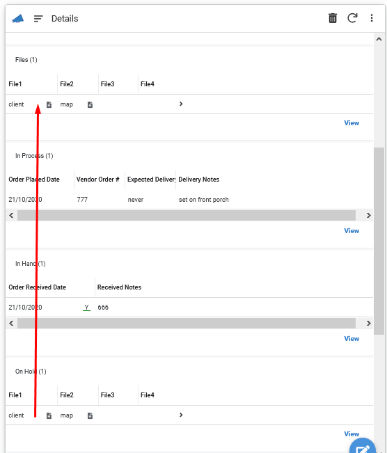

So this generates an inline view, in the main detail view, for each ref_rows VC. For 5 out of 6 of these, the system has selected the appropriate inline view to display. For 1 of these, it has selected incorrectly, and instead shows the inline view of a different slice. This is shown below, notice the inline table for โ€œOn Holdโ€ is same as for the โ€œFilesโ€:
"Screenshot
And clicking on โ€œViewโ€, in the emulator, does indicate that the view is the same one.

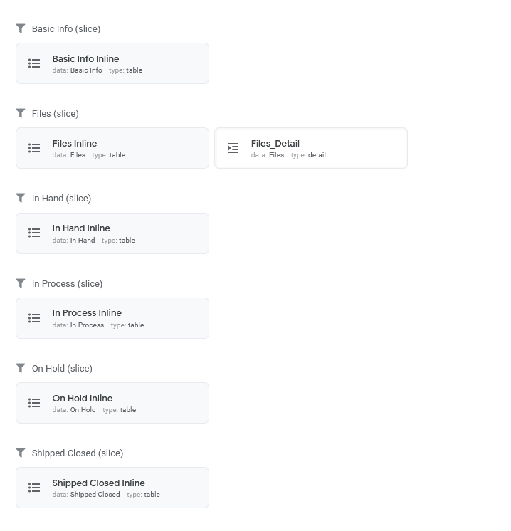

I DID make sure to create a table view, in ref position, for each slice. Here are additional setup/definition screenshots:

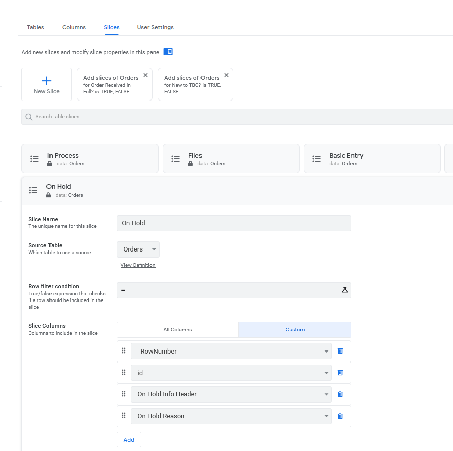

Slices:
Screenshot

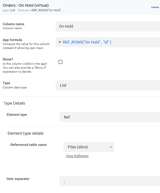

VCs:
Screenshot
Slice Tables:
Screenshot

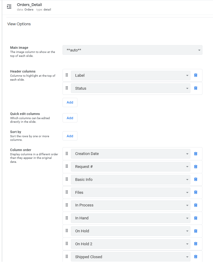

Orders Detail view:
"Screenshot
If you thoroughly looked through the above definitions, youโ€™ll notice I created a second ref_rows vc โ€œOn Hold 2โ€, with the exact same expression as โ€œOn Holdโ€. This copy does seem to work, and shows the correct inline table. So this situation is โ€œsolvedโ€โ€ฆI guess.

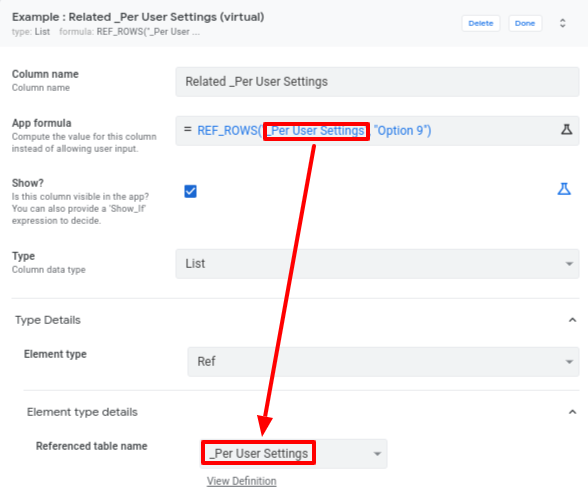

Oh wow, would you look at that. Is that a new option?
It may be relatively new, within the last six months? I agree it seems like it hasnโ€™t always been there.
Yeah, we need to save the editor to get type details appearing. I remember I make the feature request before, i.e type details should be made visible and avaiable without saving app definition, otherwise majority of the people does not get noticed that this option is in there.
