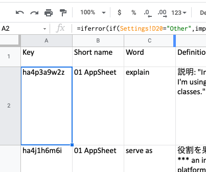

Actually, I think I might be doing what your are attempting to do.  I have a table that looks like this:

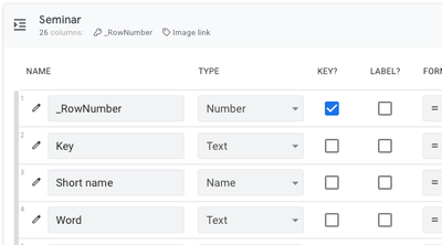

I just checked and I found that I had set the key in the table to the _RowNumber, not the "Key," as follows:
In my case, this table is read-only data that is waiting to be imported (copied) into the app.  THEN my "Key" column actually becomes a key in the table to which to data is copied.
Hope this is relevant to your situation.
Your description sounds similar to what i am doing. But it's not clear to me what steps you took to make the "Key" column the actual key instead of _RowNumber. Each time I attempt to change the key column, Appsheet reverts to _RowNumber. What do you think I am missing?
Hi @gellison! Sorry for not being clear.  In the table you see in the image above, the column with the name "Key" never actually becomes to key column.  However, when users (language students) copy a row from this table into a different table, then the "Key" column becomes a "real" key -- kind of like Pinocchio becoming a "real" boy.  ๐Ÿ˜‰
