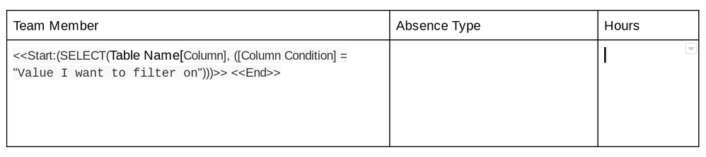

I have tried:
<<Start:[Column], [Column Condition] = “Value I want to filter on”>> <>
and
<<Start:(SELECT(Name of Table[Column], ([Column Condition] = “Value I want to filter on”)))>> <>
Both do not work.

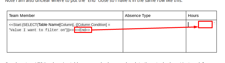

Note I am also unclear where to put the “End” close so I have it in the same row like this:

Your <<END>> expression should be moved to here:

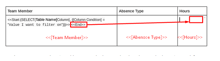

Right. So the START expression just tells the template which records to iterate over. Within each record, you still need to enter which column values to display. You need to add something like this, between the START and END.
