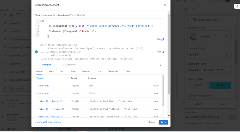

I tried the expression you gave me.
and the enum column does not show up even though the equipment name does contain the word "reach in"

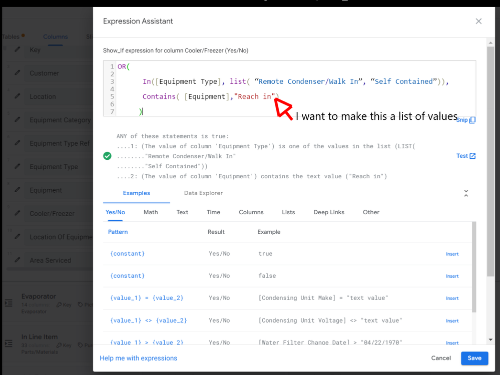

It does show the freezer/cooler enum selection

In your example yes it would be "reach in time" "walk in slowly" etc. Which is why I cannot use the IN() function I am guessing because IN() looks for exact values that match exact. Where I am looking for just part of the string to match.  I am looking to have the app look at two separate columns. Essentially it used to only look at the [Equipment Type] column so I only needed the first expression. However now I am changing things around in my app. So I want it to keep the first expression for the "old version" of the app and then also look at the [Equipment] column which has a display name of [Equipment Name] the reason for the display name is again because I am changing things around in my app and I am using this column for two different purposes. One for the "old app" purpose and another for the "new app purpose". However, the important thing I am asking is how do I get contains  to look for a list of values not just one value.
Like this but without having to write the same expression over and over again.
