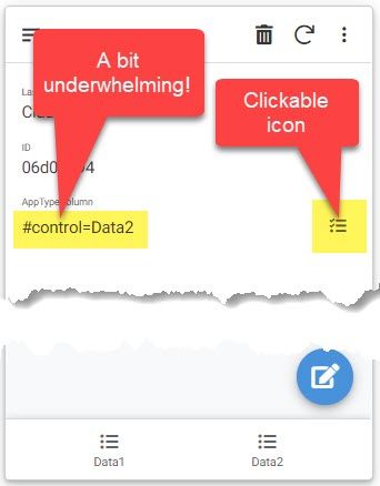

I am experimenting with the App column type to direct the user to a specific view, but I am a bit puzzled.
The end result definitely doesnโ€™t look as I anticipated. It shows a text box containing the text #control=<myview> next to a predefined clickable icon. That is very unclear to the user what clicking on the icon may do. The whole field is confusing. I was hoping to be able to show a button with a customizable name, or a link, that would open the given view when clicking on it, but not a cryptic text.

I think if you use column type as โ€œAppโ€ and app formula as LINKTOVIEW() within a column setting, it will show the navigation the cryptic way you have shown.

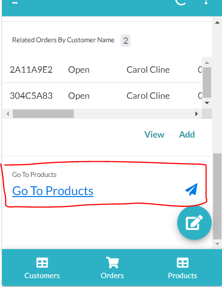

  2. Create a LINKTOVIEW(โ€œData2โ€) action in Data1 table. Create it as an inline prominence action and attach it to the VC mentioned in 1 above. The inline action will look like something below in the detail view
You can further make it look like a hyperlink by using format rules as below
