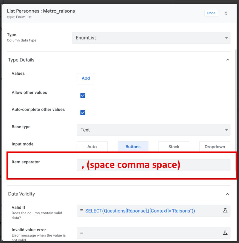

Yes … this is the basic expression I use for the valid if but it gives the error value because when re-editing the valid if constraint finds separate by comma’s values in the column.
The user should be able to change the selected values and see the unselected ones …
Can you post a screenshot showing that [Metro_raisons] column content in the sheet and also the complete column structure of this enumlist column.
3X_5_0_501f8c6b9ae18080d47ae2152ce77814824eacb0.png ie one cel from the row Metro_raisons from the sheet
structure for what the screenshot alloxs me
@Diogenes_ASBL_VZW
Your Item seperator is missing! Fill it in and try again. Presumably that will solve your problem.

Perfect … A small detail that changes my whole world!
Thank you for your perseverance!
You’re welcome.
