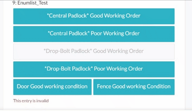

Sorry for a late reply as I was in travel and not at my desk to test.
My testing shows that the first suggestion of using AND()in place of OR() works.
Please take a look at the GIF below. The valid if uses AND() in place of OR() for combining the two sub- expressions.
May I request you to retest with AND(). I used the following sub expression in valid_if to test
AND(
NOT(AND(CONTAINS([Enumlist_Test], "*Central Padlock* Good Working Order"),CONTAINS([Enumlist_Test], "*Central Padlock* Poor Working Order"))) ,
NOT(AND(CONTAINS([Enumlist_Test], "*Drop-Bolt Padlock* Good Working Order"),CONTAINS([Enumlist_Test], "*Drop-Bolt Padlock* Poor Working Order")))
My testing showed that even the second suggestion works in valid_if. I mean the suggestion to use IFS() based expression.

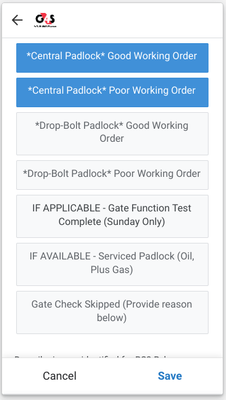

Unfortunately that does not work. It doesn't give any invalid warning as you can see from the images.
AND(
Hi Suv, Apologies for the late reply, I have been away. Yes that works perfectly. I made the mistake in not checking the spaces between the text. It does work perfectly so thank you.
