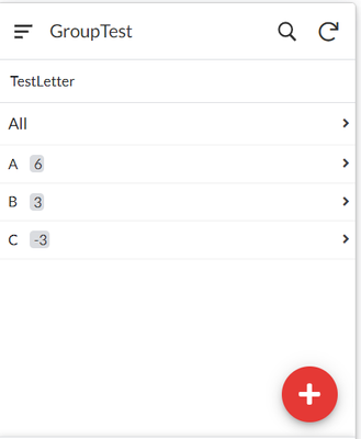

Adding to @Joseph_Seddik 's guidance, if you are just looking a single "View" to aggregate those values you could try "Group By" setting in summary views.
@Suvrutt_Gurjar Well done 🙂 probably that's what he was looking for from the beginning..

You may wish to note that if you group by more than one column, you could show the grouping and aggregation in hierarchy or stages.
