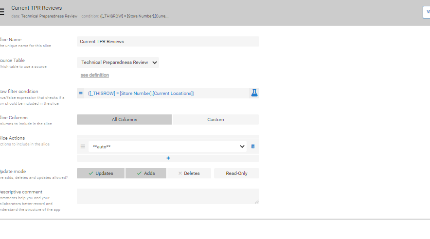

Then created a slice named Current TPR Reviews
Source Table Technical Preparedness Review
Row filer condition ([_THISROW] = [Shore Number],[Current Locations])
Then Point a UX view to this slice.
The results it shows all reviews.
Can you help?

I want to add a addition to this to also only show my reviews
Hereโ€™s the Slice view
Hereโ€™s the virtual in the location table
Hereโ€™s the virtual which the app created in the Technical Preparedness Review table
Hereโ€™s the ux
Hmm! That all looks good to me! I suggest you engage support@appsheet.com so that someone can look at you app config to see whatโ€™s going on.
