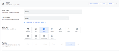

Yes, the email is my email address and it is correct.  Here's the view configuration:
