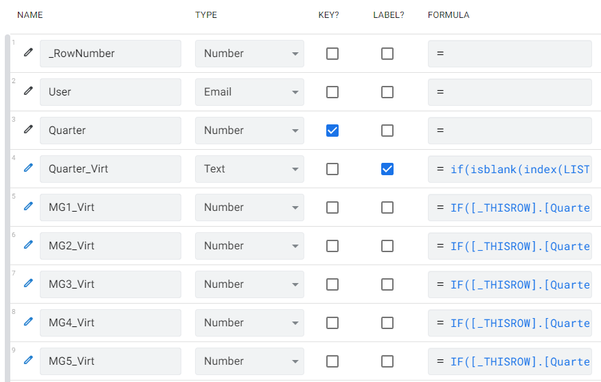

This is quite crudely built... I have a 'Chart' table where each user of the tool has multiple rows, then virtual columns that calculate the 5 different series, from my main 'Tool Inputs' table. A security filter means users only ever see their own rows in the table so the app basically sees the 'Chart' table as 11 rows and 5 columns of data that is plotted as above.

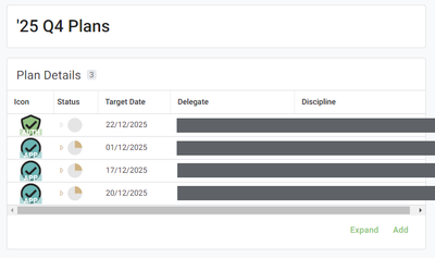

But I start to see issues as soon as I'm trying to display these referenced items in the app itself. For example, here, with the filters I have applied, there should be 3 items in 2025 Q4 with a three quarter status. You can see in the snippet of the table view next to it that this is correct, and this respects the various filters that have been applied.
If I click on the 2025 Q4 column on the chart, it takes me to a view that correctly shows 2025 Q4 items, but no longer seems to reference the slice - the green shield item was previously filtered out.

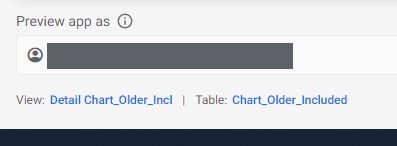

When I check exactly which view the app is going to, it is correctly referencing the 'Chart' table;
But if I hover over the Ref table and select Edit View;
It reveals that it is pointing to the table view for the overall 'Data' table - not the slice;

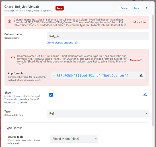

Not sure if I'm following your setup completely, but first make sure that your Ref_list column is set with a base type of Ref, and pointing to the Slice instead of the base table. This is a separate setting on the column besides the table/slice name that's set in the REF_ROWS expression.
Sorted it! You put me on the right track!
I needed to first change the [Ref_Quarter] column to be a Ref type, referencing the Charts table. Then I had to change the [Ref_List] column to still be a list, but have a list item type of Ref.
Thanks, Marc. I think you're probably right, as I currently have the Ref_list column set as a 'List' type. Changing it to a Ref and setting the source table to the appropriate slice returns a column type mismatch error though...

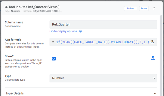

edit: in case I'm getting this wrong from both directions, here's the Ref_Quarter field;
My thinking (which may be wrong) was that;
- ToolInputs table contains the main dataset
- ToolInputs[Ref_Quarter] calculates a single value for all items in the main dataset that defines the quarter the item is against
- Charts table contains one row per quarter
- Charts[Ref_List] uses a REF_ROWS expression to return a list of row IDs for all items with that quarter
- Use the [Ref_List] column to provide detail on relevant items when clicking through on the chart view
