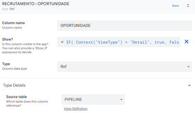

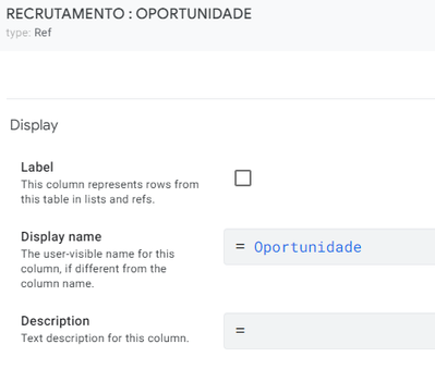

Please post a screenshot of the configuration of the OPORTUNIDADE column of the RECRUTAMENTO table down to and including the Type Details section.
Here it is:
