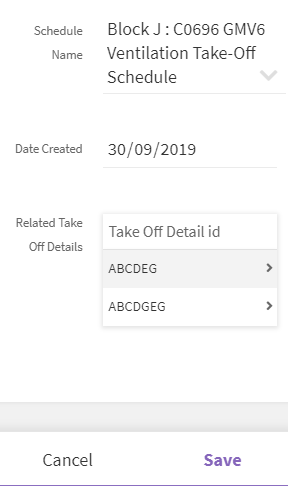

When editing in a form you can see the multiple related details (without the ability to add) so that tells me the VC and referencing is coreect. When adding a new row you cannot see the column at all.

You can’t do that with that virtual column.
When creating a parent record (take off) you can’t see the related children records (take off details) and that’s because the children do not exist.
A take off detail record needs to have a take off record to be created.
The reason you can see it in edit mode is because that Take off has related take off details,
while a new take off won’t have any related take off details as those ones will be created afterwards.
What you want can be achieved in a few ways:
  1. On the take off details table, take off column (ref), there is a check box “part of”.
    Part of means that once you delete a take off, the take off details related will be deleted too.
If checked, you’ll have a “New” button where you want that virtual column.
Once a record is added (detail), you’ll see a sub table with the details.
  1. The way I prefer it,
Having 2 views on the bottom bar :
take off (deck view)
Add details (form view-created not system)
The take off ref column will have initial value of
Maxrow(take off,_RowNumber).
The downsize is that every new Detail will get the last Take off.
If you want to add details for previous take offs then set it editable.
This way, by default, will add it to the last one but can be changed.
