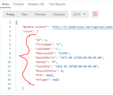

I have an API (url) built in json to bridge my app to another software. The only documentation i have is the url.
Whatโ€™s expected (sample data that is in the table):

Probably wrap that entire Body expression in this as well:
"value": [
*existing body here*
As shown in your first screenshot from Postman.
Ok. I think this is right, but it still gives the same error:
Do you need that @odata.context field too?
