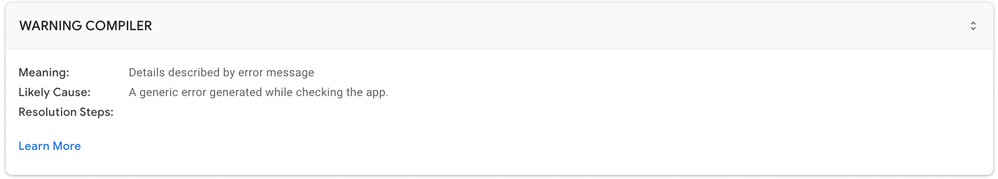

What dose this error message suggest? "A cycle is detected in the component"
One of my tables starts to show a Warning as below.
A cycle is detected in the component. This can result in undefined and erroneous behavior. It will eventually be marked as an error.
ใ‚นใ‚ฏใƒชใƒผใƒณใ‚ทใƒงใƒƒใƒˆ 2023-01-28 7.54.18.pngใ‚นใ‚ฏใƒชใƒผใƒณใ‚ทใƒงใƒƒใƒˆ 2023-01-28 8.02.35.png
Is this means some expression has "circular reference" like excel?
๏ผˆalthough I certainly haven't touched the table or its expression when the warning appeared๏ผ‰
Thank you for your all advice.

That's interesting just received the error as well on a single table. I have a security filter in place too.
Same here
Is this because of something newly added?
I have it too, also on a table with a security filter in place .
Same Error here, out of nowhere
"A cycle is detected in the component. This can result in undefined and erroneous behavior. It will eventually be marked as an error."
I'm also getting this weird warning - did not change anything
@llynch Madam, is this error because of any new update or change made by Appsheet team
Got the same error as well - completely out of the blue.  Have not changed anything and it shows up on only one table in spite of using the same security filter on multiple other tables.
Also noticed another weird behavior.  The interactive mode on the dashboard has stopped working.
I also have this message on of my table... and security filter is the same of another table wich its have no message?!....
Thanks advance for the answers
I have two very similar apps and they both have this issue displaying, but on different security filters. I'm hoping that there is an issue with the evaluation process rather than our apps.
Seems related to the discussion about circular references that followed the December 6, 2022 - Google Cloud Community release notes. See @poy's comments there.
It also seems like there may be some false positives in the warning's logic since my observation is that security filters that involve a circular reference result in an app not loading, even though AppSheet has not previously flagged that error for app creators.
Also, in one of my apps, the warning just appeared for a column that has an intentionally circular reference in its Editable? property. I hope that doesn't ultimately become deemed an error that prevents an app from loading.
Having this issue today with one of my app?
The ability to warn of circular references would be useful.
However, the logic of this feature may not be sufficient at present.
Because I have confirmed the following phenomena in my application where this warning is occurring.
* This warning occurs even when only NC (Normal column) is used in Security filter.
* If I set the Security filter to NULL, the warning disappears.
If it is a VC circular reference issue, I think the warnings should keep showing up anyway.
However, since that is not the case, I believe there is room for improvement in the logic.

I don't yet understand what's circular in my apps , but I will keep trying.
It only  flags one table , in any of my apps with security filters, even if I have multiple tables with similar security filter.
The one in the photo is a physical column , autocalculated with an appsheet formula on row adding (numer of working days between two given dates,minus bank holidays etc).
โ€ƒedit : the formula is not flagged, only the security filter is flagged
I removed the security filter from my table in the above photo, and it still did't flagged the column formula. Instead , it flagged another table in app. I put the security filter formula back in first table, and it reflagged it , while removing it from the "another" table.
So I can conclude so far it only flags one table per app. Still don't know the flag reason
Same here - no idea what is the reason
I am not able to figure out why would the security filter on a normal physical column would be flagged as circular reference.  Another thing is that I have this same filter on other tables, but those have not been flagged as circular reference
This is the filter I am using:
if(in(useremail(), select(superuser[user id], true)), true, [user id] = useremail())
Perhaps it's somehow confusing columns with similar names? I have [ziLE cal] and [ziua cal] , also [user] and useremail in others.
Or with the columns marked as "this expression could impact performance" .
Can't yet find another common nominator
