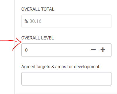

I have an assessment sheet in Appsheet where people input different scores for people. Then Appsheet calculates the overall percentage. What I now need is a formula which works out what the overall level is, based on the % score
(0-21%= Level 0
22-54%= Level 1
55-85%= Level 2
 86% and above= Level 3.)
But I just cannot work out which formula to use. I basically want it to look at the row above where the % score is, and then calculate the level based on the above criteria. I tried using IFS AND but I couldn't work out how to get this working.
Your help is hugely appreciated! Thanks!

Thank you, but I am getting this error message:

Thank you but I am still getting an error message like this:

Thank you very much! This now works perfectly! Really appreciate your help!
