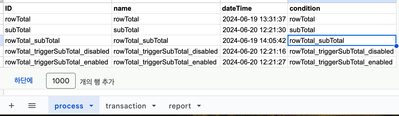

My work has these 3 steps:
< 1step >
To register transactions to the transaction table.
< 2step: rowTotal >

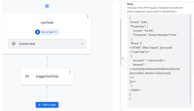

To sum the transaction amount with each account by running the process of Call a webhook.

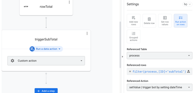

< 3step: subTotal >
To sum the rowTotal of the first step of the bot to the subTotal by running the process of Call a webhook.

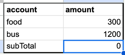

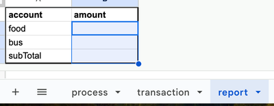

โ€ป The transaction table is as follows.
โ€ป The report table is as follows.
โ€ป I have 5 bots. And this is the result of running each bot.

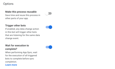

Wait for execution to complete?

enabled
[Question]
Like the result, there is no difference between no.4(disabled) and no.5(enabled).
BTW, what I expect from disabled is this:
What is the difference between disabled and enabled of "Wait for execution to complete?"?

That option is typically helpful for large-scale API operations involving a lot of records that could take a lot of time, but you don't want the app user to have to wait for them to complete for their sync to finish. Sometimes the user needs the updated data before they can do something else, and sometimes they do not, switch the option appropriately.

I believe my understanding of that option is the same as yours. To verify my understanding, I had created a sample app and checked it. That is, summing the values โ€‹โ€‹of the transaction table into the report table (hereinafter referred to as "rowTotal") and adding up the aggregated values โ€‹โ€‹again within the report table (hereinafter referred to as "subTotal"). I had tried this(rowTotal and triggering subTotal) for each option, but contrary to my expectations, the results for each option were the same.

bot1: subTotal
subTotal step
bot2: rowTotal_triggerSubTotal_disabled
rowTotal step
triggerSubTotal step
options
bot3: rowTotal_triggerSubTotal_enabled
bot3 is same with bot2 except this option:
=> The bot2 and the bot3 have a same result like this.
before running bot:
after running bot:
