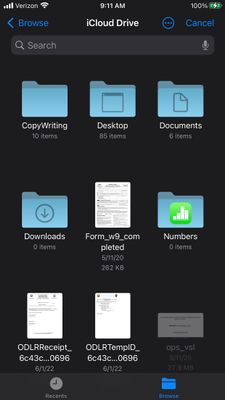

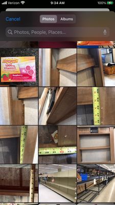

@Mônica What specific file types are users interacting with in iOS? As noted in the provided article,  they should, in a "File" type column, be able to attach any common image files, PDF's, Text and maybe sound and video files.
  • "Image" type columns will search the camera roll on the device.
  • "File" type columns will search the file list
Camera Roll open when tapping on an "Image" column to add an image
File Navigation service opens when tapping on a "File" type column
NOTE: By design, only certain files can be selected.  Bottom right file is disabled - a Keynote file.

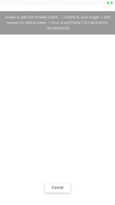

Hmmm, I get it! Looks like the user has to save images to files to be able to localize it, I made some tests and get this error:

I did play a bit with trying to upload images from an iPhone using a File type column.  I couldn't even access the camera roll.  Not sure how you were doing it.  To upload an image captured from the device I had to physically move it to a folder that I could then access with the Browse option.
However, I couldn't upload images this way at all.  Upon save, the app would get "stuck" and not push the edit through.  When I tapped Sync, I would get the error message in the image below.
I could upload these same images using an Image column with no issues.
What is more puzzling to me is the difference in behavior.  I do have the latest iOS (on an iPhone 7) and the latest AppSheet.  Please make sure you do as well in case the behavior changes on you.
I did the same thing to access the images, physically moving it to a folder on "Files". When the bot that concatenate the URL run, the sync fail and we get the error.
