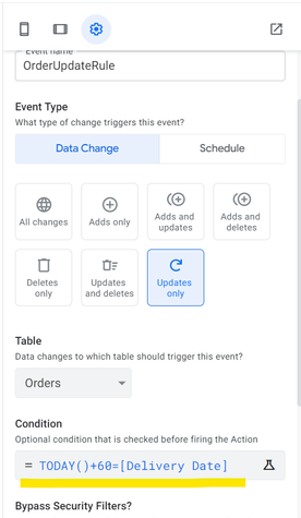

Just for community benefit, you may want to share more details about the BOT and where the condition is used and not working. Maybe your configuration and requirement is different than the example tested below.

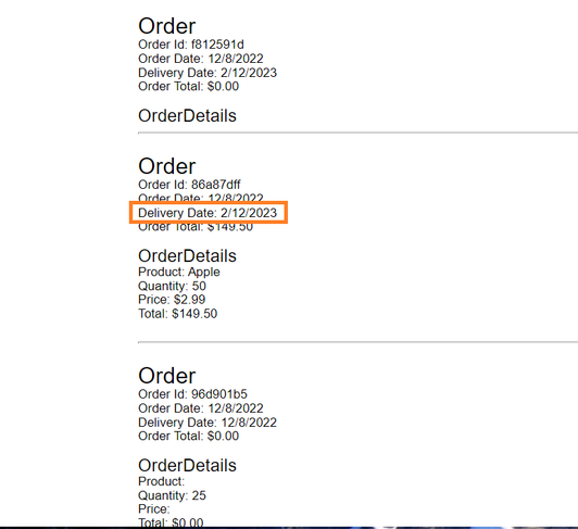

I tried with a data change bot and the bot fires for the [Delivery Date] of 5th February 2023  if fired today on 7th December 2022 with the following condition.
Email body of the email fired from the bot below.

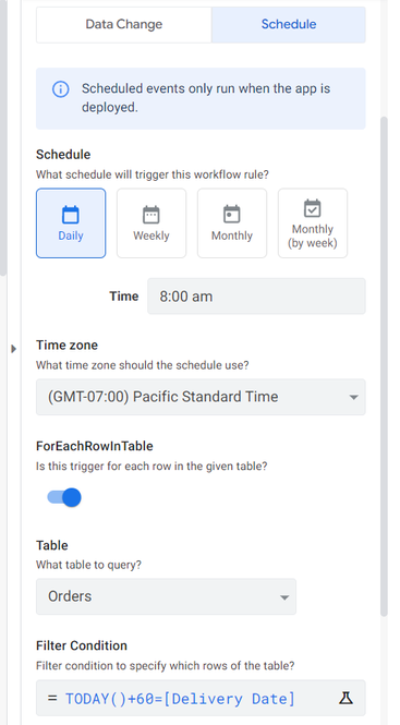

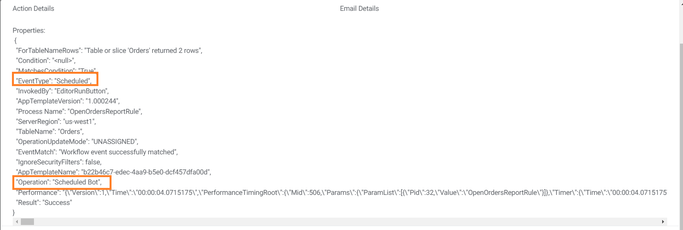

Thank you @Julien . At least in my test when I ran a scheduled bot with a similar condition , it ran well. Of course since my app was not deployed, I tested it with Run button. But it selected records after 60 days from today and sent emails.
