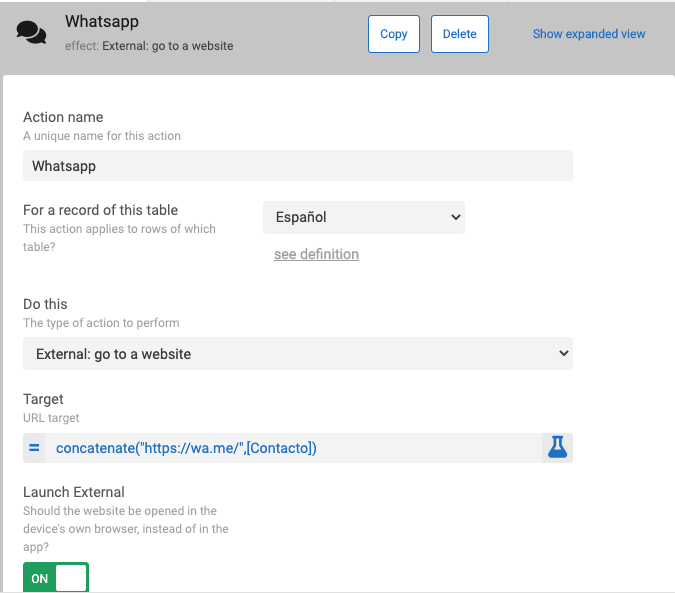

Sure, Colin, this is what Iยดve done. Really easy.
  1. iยดve set up an action:
The basic target URL for whatsapp messaging is: https://wa.me,โ€œphonenumberโ€
This works if you just type your phone number in the โ€œphonenumberโ€ field.
Although if you want the phone number to be pulled from a column use the CONCATENATE formula like in the screenshot. โ€œ[contacto]โ€ is the name of the column where I have the phone numbers.

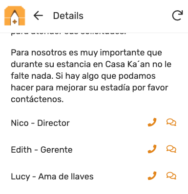

  1. This is the result:
Hope this helps!
*NOTE. You need your google sheet or wherever your data table is to show the โ€œ+โ€ sign in front of the phone number. Otherwise, itยดll probably wont work. To accomplish this, just add an apostrophe โ€™ before the + symbol. This way Google Sheets, recognizes your input as text, and wont delete the + symbol.
Hope this helps!
