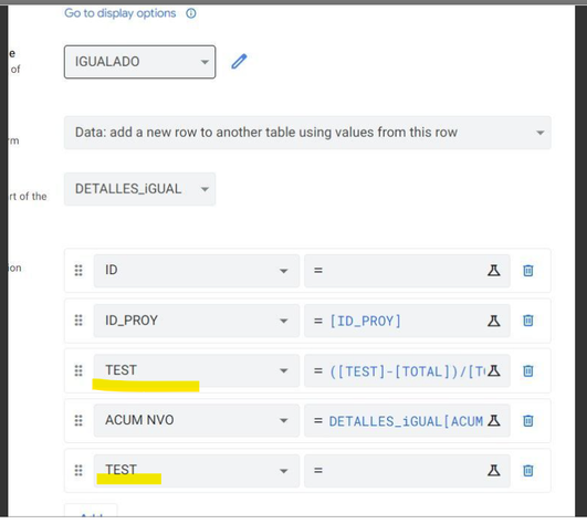

I have two tables in a parent-child relation. In one of them I have a "project"; in the second i have a series of adding-up numbers for that project with color names:
Row 1 5 of yellow,
row 2: 8 acummulate of red (makes 5 of yellow and 3 of red),
row 3: a new accumulate  of 10 of white (5Y, 3R, 2W).
For those of you asking, yes, it is a mix of paint. Now back in the parent table I want to make a test from the mix, and after that, substract equally from the 3 ingredients in the child table.
It would be so logical to think that what I need is to create an action which "adds a new row to another table" (the child table) with negative numbers looping to all of the three rows  (lets say, if I put 0.5 in the parent table - 5% of the initial total - it will be -0.25 of Y, -0.15 of R  and -0.1 of W).
But Appsheet is'nt that logical or easy. No sir. In first place, I created a new virtual column in the parent table that calculates a negative % to substract from all the rows of child table. So far so good. But that is where logic and common sense stopped.  I tried to make the action adding a row to another table, but Appsheet shows me the columns of the parent table, no the child I want to act upon.
Then i got this:
Say what??? Appsheet is not able to calcualate 0.05 * 10?

The expression you have shared is multiplying a list with another column and that is why you are getting the error.
Please try  ANY( Detalles_iGUAL[ACUM ANT])* [_THISROW].[Test]
This will probably pass syntactically but may not be what you may really want.
This is so because  ANY( Detalles_iGUAL[ACUM ANT]) will get the first element of the list produced by Detalles_iGUAL[ACUM ANT] which you may or may not want.
Also you seem to be having two [TEST] columns in the same table which is not correct.

Hello: Thanks for all of your help.
Sorry for not understanding that. As en Excel user, I am used to the basic notion that by multiplying Y x Z, I will get a straight forwarded result. In a virtual column, if I am not in error, it goes that way: ([Test]-[Total])/[Total] gives me a negative % number, just as I expect. After seeing how easy that one went, I ventured to create the Action thing, and got dissapointed again. I am starting to assume, or infer, that virtual columns have a different criterion than "normal"  columns.
