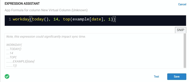

The third argument to WORKDAY() ex expected to be a List, but INDEX() returns a singular value.
TOP() returns a List of the first N elements from its List input, so it can be used successfully to get the first element of the list:
Going back to INDEX(): should we need something other than the first element of the list, wrap the INDEX() output with LIST() to make a one-item list:

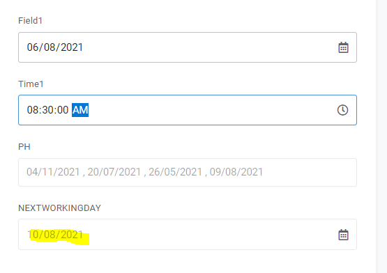

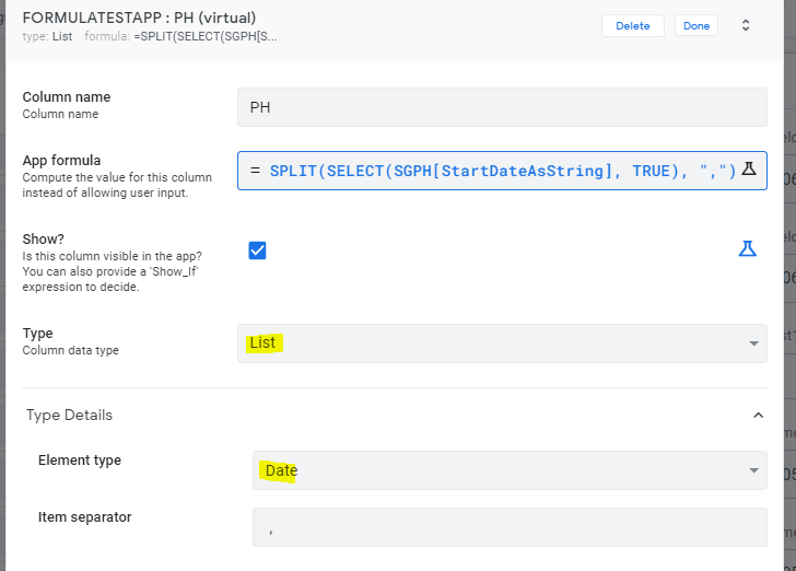

I’ve tried all the suggested workaround above and all didnt work. I’ve notice that WORKDAY(), if added list of Holidays only works if the list of dates is in this format “mm/dd/yyyy”.
Here in SG we use “dd/mm/yyy” so just like others, I struggled in getting the next working day taking Holidays in consideration.

In my Main table, I have added two virtual columns, 1st column is to get the list of Holidays from my SGPH table using the virtual column [StartDateAsString] I’ve added.
2nd column is where I apply the WORKDAY() formula.
In the 1st column, the formula goes like this: SPLIT(SELECT(SGPH[StartDateAsString], TRUE), “,”)
Here I set the Type as List and Element type is Date.
In the 2nd column, the formula is like this: WORKDAY([Field1], 1, [PH])
I set the Type as Date
Doing the above steps, Im able to get the next working day and taking the holidays in consideration.
