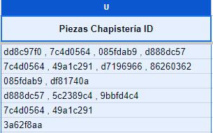

This is the enum list with base type Ref column.

This is the "Piezas Chapistería ID" column in my Google Sheet.

I have to create a PDF, so if I do it with the "Piezas Chapistería ID" column, I'll get the keys instead of the labels (values) of those keys.

SELECT(Piezas Chapistería[pieza], IN([Pieza id], [_THISROW].[Piezas Chapistería ID]
I knew that the IN expression is a Y/N expression, but I didn't realize that used together with the SELECT expression it is like SELECT(Table[Column], TRUE).
The formula works fine. Thank you @TeeSee1.
When entering the formula, the editor gave me an error because it automatically sets it as a LIST type column and only virtual columns can be of this type. I tried columns of type EnumList and Text, and the formula works with both.  Does it matter if I choose one or the other?
