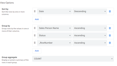

Shalin has a total of 14 orders. but the count for the row number is wrong. inside "shalin" the row number count is right. all other counts for the row number are absolutely correct only there the name "shalin" is the wrong count.

Are you using COUNT or SUM as the aggregate value for the Groupings?  If you are using COUNT then this is a bug and needs to be opened to AppSheet support.  If you are using SUM then switch it to COUNT.
I am using COUNT. All other row counts of the names are right only the name "Shalin" has this wrong count.
I would report to AppSheet.   In the meantime, two things to try:
1)  There is a difference in Sorting and Grouping.   Grouping implies a certain sort order and maybe the differences are causing confusion.  Apply sorting as:
  • Sales Person Name
  • Status
  • Date
2) If above doesn't work then un-group the view and only apply a Sort and check that you see 14 rows for Shalin then.
@debajyoti   Did you try #1 above?
yes. but no result. thanks.
