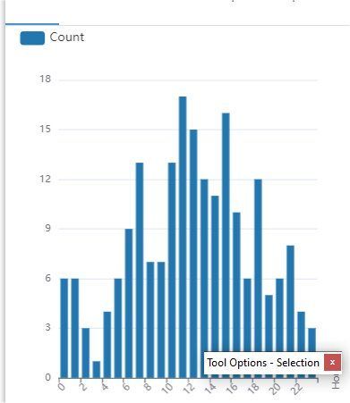

Not sure if this can be done but I'll ask in hope.  I want to visually compare 2 years of data via a chart. Now I have created 2 slices, 1 for this year and 1 for last year, that isn't a problem. Previous year was created using "(YEAR([Date])=YEAR(TODAY()-365))".
I can't see a way of comparing both slices on 1 chart and can't see a way of doing it. I have attached images of the difference in the data.Current YearCurrent YearPrevious YearPrevious Year

The data is showing incidents recorded at what 'hour' over the course of the year. So have sliced the current year and previous year to this current year.
I've create a virtual column which lists "Hour/Year". An example is an incident that has occurred at 2pm in 2021 the result is 14/2021 and an incident occurred at 2pm in 2022 will return a result of 14/2022, I get the results but that does not return the same sort of graphs as shown in previous post.
I want to display both years together so you can compare instead of using 2 separate graphs.

I have seen the light and am now using another table to get the desired resultsCombined Data.png
