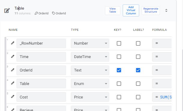

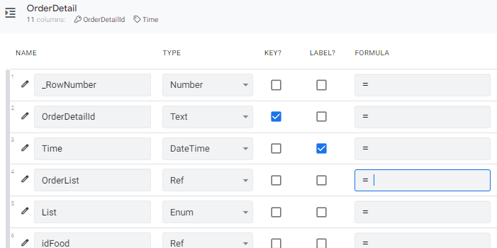

 i got  yellow triangle warning  with  reference column is a part of  other table .How can i fix it
this is  parent  table
and  child  table

Are you seeing this when you create an order, add an order item, then before you save the parent order? If so, saving the order should make it go away.
Yes it not  warning   when  i save.  That   mean  it normal   aleart  until i save  right ?
Yes. You can go ahead and save the order.
Until you save the parent order, the data does not exist in the backend data store, and therefore, the ref column in the item data thinks it is invalid, hence the warning icon.
Thank you 😍🙏
