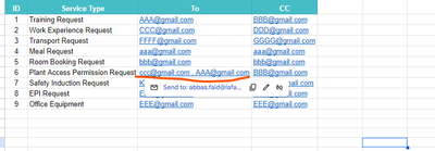

    I want to have an automation process to send email with(To and CC) recipients in a table based on service type .I want also to send an embedded app view as email body to have Approve or Reject answer to the requester.Here is how my table looks like:
What are the steps of making the bot and the embeded appview knowing that my Requests table has the following headers:

I have used an expression both in to and CC as follows:
IFS([Service Type]="Training Request",select(Services[To],[Service Type]="Training Request"),[Service Type]="Work Experience Request",select(Services[To],[Service Type]="Work Experience Request")......
But what if I have two or more recipients in To colum like my case above:

I'm guessing the "Service Type" column in your "Requests" table is a REF to the "Service Types" table, in that case use these dereference expressions instead for your To and CC fields, respectively:
[Service Type].[To]
[Service Type].[CC]
