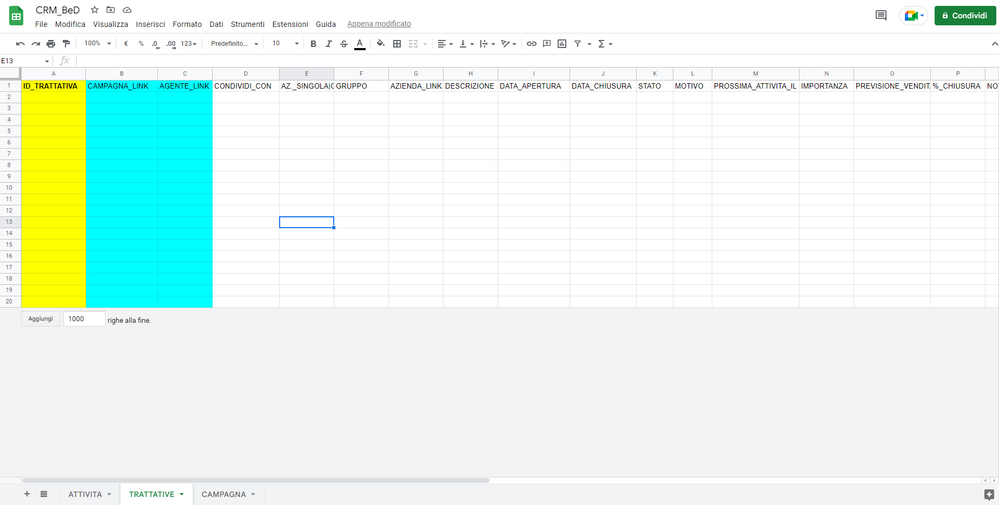

these are the tables.

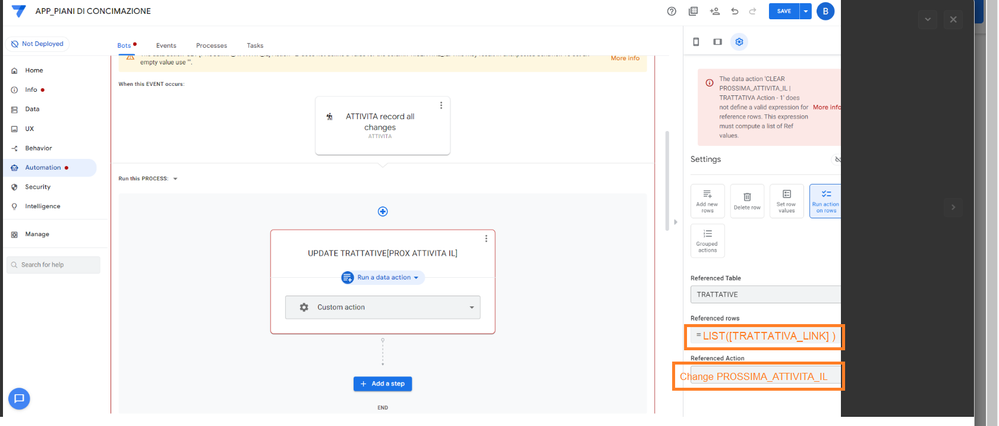

 i try this way, but my biggest problem is when i have to give a condition to filter the rows.
maybe I'm a little confused about the process

I believe your expression for the referenced rows will be LIST([TRATTATIVA_LINK] )
You will also need to add a data change action called say "Change PROSSIMA_ATTIVITA_IL" as a referenced action as shown below.
The expression of this data change action ( type: change values of some columns in this row) that will change the [PROSSIMA_ATTIVITA_IL] column in TRATTATIVA table will be something like MAXROW("ATTIVITA", "RISENTIRE_IL", [_THISROW].[TRATTATIVA_LINK] = [ID_TRATTATIVA])
thanks I try now !!
