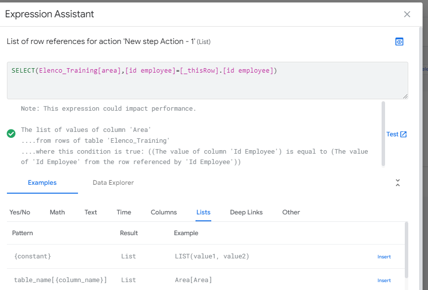

Hi everyone, after various requests and help received thinking that it was the formula I used in the BOT, having done a test, I receive this error but I don't understand what it depends on, do you have any suggestions? I saw that other users had the same problem, thanks1.png

If you are referring to Elenco_Training table and trigger an action from it, the result in the formula needs to be list of key values in that table. Otherwise it doesn't find any rows to trigger. Though if you have same key values in the Elenco_Training table and in the Ref column, it could find those rows but I don't believe that's the case in here.

Hi, thank you, the action I perform is this, if I activate it with the button for each single line it works, with the Bot it doesn't work1.png

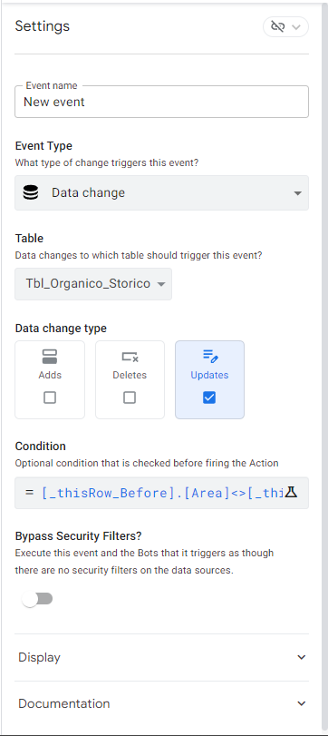

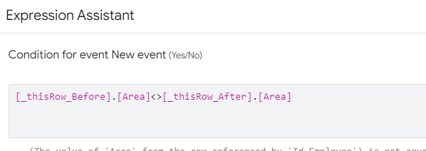

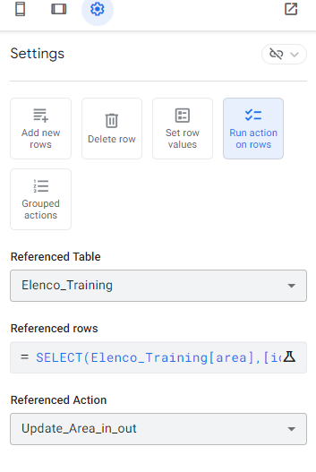

And what is your Bot setup?
Is the [Area] a key column in Elenco_Training table?
No, the key is "KEY" because in that view I should also add other courses so I put "KEY" as the key with the starting value uniqueid(). The AREA column refers to the "tbl_organico_storico" table1.png
