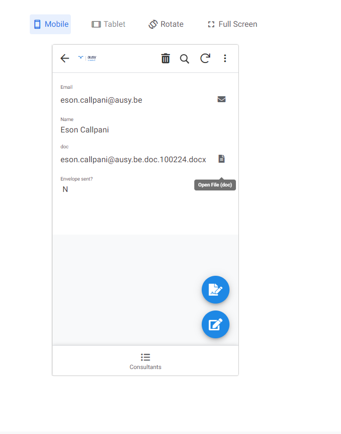

This is my uploaded document input:
input_Files_/eson.callpani@ausy.be.Attach document.133656.docx
This is the virtual column input:
https://www.appsheet.com/template/gettablefileurl?appName=CopyofTelewerkPolicy_CXO-6324719&tableName=input&fileName=input_Files_%2Feson.callpani%40ausy.be.Attach%20document.133656.docx

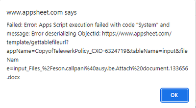

 When running the script I receive the same error:
Could you point out what I'm doing wrong?
Try to quote the url, and see how it goes.
var uri = Utilities.base64Encode((DriveApp.getFileById('https://www.appsheet.com/template/gettablefileurl?appName=CopyofTelewerkPolicy_CXO-6324719&tableName=input&fileName=input_Files_%2Feson.callpani%40ausy.be.Attach%20document.133656.docx').getBlob().getBytes()));
I tried quoting it and afterwards inputting the variable in the main function but stilll same  error persists.

When  trying to run the appscript seperatley from the appsheet by using the file url generated  in the appsheet i receive this error:
Error
Exception: Unexpected error while getting the method or property getFileById on object DriveApp.
When trying  to run the script from within the appsheet by  using the automation testing environment, still the same error persists:
Seems like the Utilities.Base64Encode function is  failing to retrieve the file by  id for urls generated through appsheet file upload.
Any other possible solutions I could explore?
