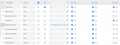

Hi @WillowMobileSys ,
I'm testing your solution, but it doesn't work.
J'ai essayรฉ l'appformula suivante mais j'ai encore un message d'erreur:
IF(AND([Statut Fournisseur] = "Principal", COUNT(SELECT([Code article][Statut Fournisseur], [Code article] = [_THISROW].[Code article],[Statut Fournisseur] = "Principal")) > 1))
It's my table (supplier condition)
And i have 2 tables, one call "Parts", in french "Articles" and one "Suppliers" in french "Fournisseurs". I have a ref between the Parts table and "Supplier Condition"
why it doesn't work ?
I'm going crazy because I've been trying since this morning ๐Ÿ˜ต ๐Ÿ˜ก
First, I thought by your original post, you are trying to filter the dropdown list choices?  In your screen shot it appears that you have placed this expression in the App Formula - which is not the correct place to affect dropdown lists.  If you are trying to filter the choices, then you want to place the expression in the Valid IF property of that column.
Is this the full expression?  If it is, it's not at all close to being correct.
An IF() requires 3 parts - Condition, if condition True expression and if condition False expression.  It appears you only have the Condition part.
Please describe in words what you are trying to accomplish with this expression.

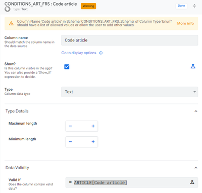

There are two relationships in the "conditions-suppliers" table
- article code in "valid if" / data valitidy -> article code from article table
- suppliers in "valid if" / data valitidy -> suppliers from the suppliers column
Supplier conditions are used to assign a supplier to an article.
For the same article, I must have only one "main" status for a supplier. If I want to buy the same article from another supplier, he must have the secondary status.
I thought my formula did this: it checks the number of times the same item is present, when it finds 2 identical items: it checks the name of the supplier, it must have a main supplier, if there are two suppliers with a main status there's a message for the user.
Finally, when choosing a supplier for an item, the user will be able to choose the primary status if it's a primary supplier, but a message will be sent to inform the user that the same item exists with another supplier, so the secondary status must be chosen.
Sorry for the long explanation and I hope I've made myself clearer
