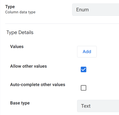

I had this error message because of ENUM columns. In the Database they were set to
Type: Enum
Item type: Dropdown
I changed the Item type to "Text" and enabled "Allow other values".
This is how I set it up in the App:
