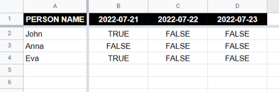

Lets say we are having TEST table represented within google spreadsheet:
Ok, and now I would like to change the value (from False to True) with an action. The Action is triggered during the DAY for the defined PERSON.
So... the action triggered on 2021-07-22 for Eva should change the value in cell C4. Next day, on 23rd of July, when triggered for John should mark cell D2 to True. And so on...
0 12 1,232

Not possible.
I suggest re-configuring your data structure. Individual dates should not be columns, you should have a "date" column where the dates are the values. Lookup terms like "tabular" and "normalized" for more info on proper database structure. Appsheet also has a few help articles on the subject.

Unfortunately I'm not the owner of the spreadsheet, and it is just shared document. I wanted to automate updating it.
Is there a chance to access the separate spreadsheet file (not a data source) and modify vales in defined it?

e.g.: Is it possible for appsheet to modify spreadsheet cells' values using their range addresses?
No

It seems the only solutions would be another table with data manipulated with macro or formulas on spreadsheet side. And macro to update related range in original file. Im going to focus on this.

I've make the solution with two spreadsheet and some apps script code to handle updates and make some queries.
