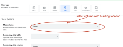

Set Buildings_Inline view to Map type
Set the column that contains the building location - Address or LatLong type
