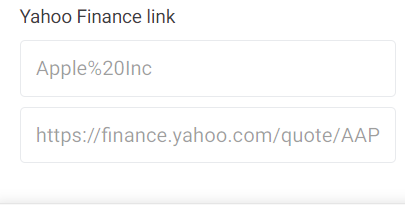

I tried to create a hyperlink like the one below,
I set it up like this, the column type is url.
but what I got is this,
Did I miss something? I would like to result in the first picture.

You won't see the hyperlink inside the Form because actions do not work there.
If you want to have a link inside a form for guidance, check Show columns:
https://support.google.com/appsheet/answer/10106435?hl=en#show
Please post a screenshot of the configuration screen of your Show-type column.

Please try wrapping [Q1 Target] with ENCODEURL()
ENCODEURL([Q1 Target])

I did this, HYPERLINK([Yahoo Sustability Page],ENCODEURL([Q1 target]))
it doesn't seem working?

Hi @helenyeliu
You second picture looks like a screenshot from a form view.
the 1st picture looks like a detail view.
You may want to look at Behavior>Actions>Show system Actions> and pick your action.
Then:
Appearance>Attach Inline> and pick the column to which you desire your url link to be displayed with.
thanks!
1st and 3rd pictures are the screen shot from a form view. 2nd picture is how I set up the hyperlink, I would like to see the result shown in 1st picture instead of the 3rd one.

I added attach to column like this, it still doesn't show the link.
I define the hyperlink as this
the result is still
I am using Form type for this table.  Am I able to setup the link?
Thanks!
Helen

  I found that I already setup the column using Show, it doesn't seem help. Do you have an example for this?
Thanks,
Helen
Hi
finally Using Show column solves my problem, thanks much!

Hi @helenyeliu
hyperlinks are basically actions.
They can't be used within a form view type.
