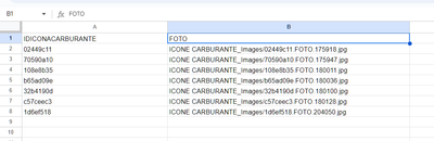

In the database the images are classified with the IMAGE type. Appsheet has put them in the sheet and inserted them as url.
The image represents a stylized shape of the fuel level of a vehicle. You will find different ones depending on the condition to be represented.

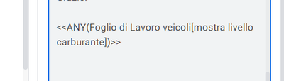

I'll try to post some images to help understand better.
Example:
ciao @JSO
thanks for the reply, so I applied, I hope well, your suggestion.
unfortunately I get a blank space, nothing else. Where am I going wrong?
Try putting a specific image in the FORMULA for "livello carburante" (any URL you find on the internet and the file ends with .jpg).
If that works, the problem is in the formula assignment.
Now you have it defined as the content of a field [livello carburante] which is of type REF, and that is not an image. As AppSheet tries to control errors, what it does is return a blank image.
