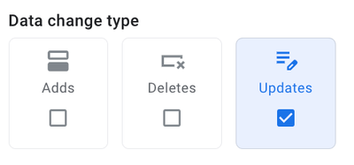

In the bot, set the event to "Update only":
And to trigger it only upon update of this particular column, not any column, you should put the following expression in the bot's "condition":
NOT([_ThisRow_Before].[counterColumn] = [_ThisRow_After].[counterColumn])

No problem, let's take it step by step:
  1. First, please have a *new* physical column, let's call it "Counter", type Number. Set its Initial Value to 0
  2. In your "OraFinalizareControl" action, click on "Add", select your "Counter" column, and put the expression in the field on the right to: [Counter] + 1.
  3. Set your "OraFinalizareControl" action, as the Form Served action of your form view.
  4. Set your Bot's event to "Updates" not "Adds", and put the following expression as a Condition:
    NOT([_ThisRow_Before].[Counter] = [_ThisRow_After].[Counter])
