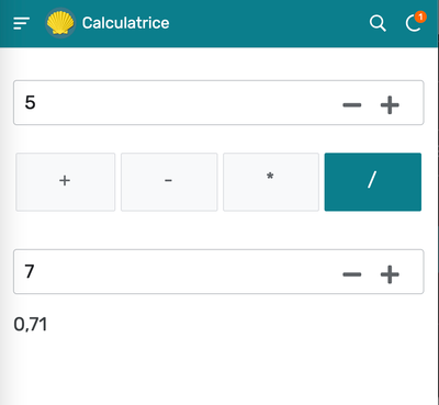

I don't think it can be done the way you say. I have a dose calculator that works quite well but I can't use it in a detail view as you say, simply no column appears
Yo tengo una calculadora de dosis que funciona bastante bien pero no la puedo usar en una vista de detalle como dices, simplemente no me aparece niguna columna

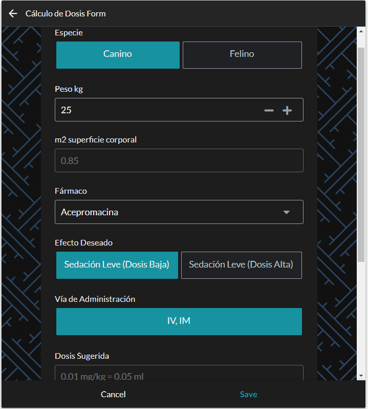

I leave some captures so that forexmajed does not lose heartCalculador vacio.pngcalculador lleno.png
You are wrong, you should read..
Capture dโ€™eฬcran 2022-07-19 aฬ€ 06.35.24.pngCapture dโ€™eฬcran 2022-07-19 aฬ€ 06.35.40.pngCapture dโ€™eฬcran 2022-07-19 aฬ€ 06.35.52.pngCapture dโ€™eฬcran 2022-07-19 aฬ€ 06.36.04.png

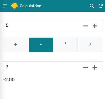

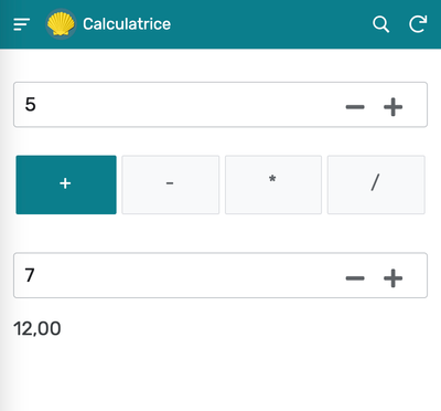

I know you can make a simple calculator like the one you show but if you read...

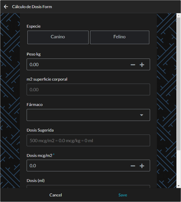

forexmajed  you need at least:
1.- A table with a list of medications with their concentrations, the columns would be: [Drug ID],[Drug Name],[Concentration/ml],[Dose mg/kg]
2.-Another table with the columns: [Dose ID], [Weight Kg], [Drug ID](Ref), [Calculated Dose].
3.- The magic happens in the [Calculated Dose] column since it will contain a formula like: [Drug ID].[Dose (mg/kg)]*[_THISROW].[Weight Kg]/[Drug ID].[Concentration/ml]
4.-All the columns involved in the formula must be number or decimal type, otherwise you can always specify it in the formula
Joseph_Seddik This is the simplest and easiest way I know to calculate drug dosages in a form view. I don't doubt that it can be achieved in a detail view, in fact I would like to achieve it but as I told you I already tried and I was not successful. any idea why?

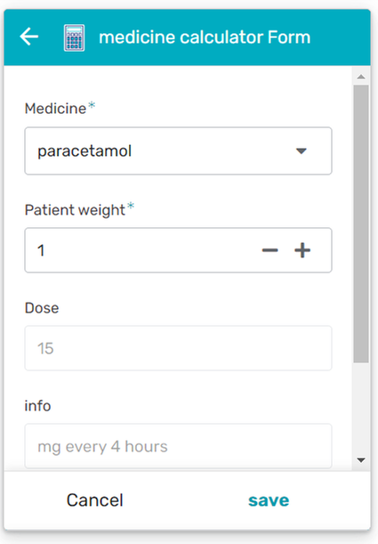

I mad it by simple formula , i create column to each medicine name and  one for fixed number for each medicine ( as akey number for each medicine ) and one Colum for patient weight  and also one for dose = [Patient weight] * [mg per kg]

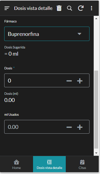

The problem is that no field appears in the detail view
El problema es que no me aparece ningun campo en la vista de detalle
Put initial values in non calculated fields, make sure calculated fields will evaluate to a result based on these initial values, use app formulas and valid if expressions in calculated fields to account for non permitted calculations like division by zero, and they should appear.

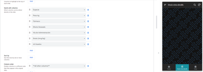

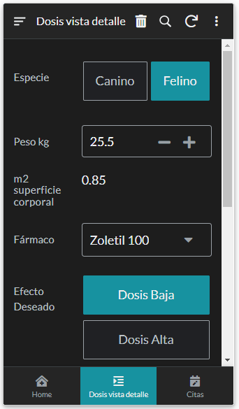

Thanks for the answer, in the morning I managed to get all the fields to appear in the detail view, the problem was that I did not have any data in the table (I had read it but I was confusing the table with another that does have values inside โ€Œโ€Œ๐Ÿ˜… ). When I added the ID directly to the google doc that problem was solved, I even removed the edit button and tried it a bit...
The drawbacks I find are:
1.-It has to be synchronized every time a value is entered in a field, can this be changed?
2.-In my particular case I have columns that are dependent on others, an example: "Efecto deseado" is dependent on the "Fรกrmaco" and viceversa . The inconvenience is that if I have selected a "Drug" and its "Desired Effect" (As in the first image) and I change the Drug to another that does not have the same desired effects... All the calculations stop being carried out giving empty fields or with 0 as the result, the worst thing is that the "Desired effect" option disappears (I guess because of the Valid_if) so it looks:
To solve it I have to find the "Drug" that has the options selected
I think that to solve this problem it is necessary to add a button to clear all the fields, what do you think?

Gracias por la respuesta, en la maรฑana logrรฉ que aparecieran todos los campos en la vista de detail, el problema era que no tenรญa ningun dato en la tabla (Eso si lo habia leido pero estaba confundiendo la tabla con otra que si tiene valores dentro ๐Ÿ˜…  ). Cuando agregรฉ el ID directamente a el doc de google se resolviรณ ese problema, incluso ya quitรฉ el boton de editar y lo he probado un poco...
Los inconvenientes que le encuentro son:
1.-Tiene que estar sincronizando cada vez que se introduce un valor a algun campo, esto se puede cambiar?
2.-En mi caso particular tengo columnas que son dependientes de otras un ejemplo : "Efecto deseado" es dependiente del "Fรกrmaco" y viceversa. El inconveniente es que si tengo seleccionado un "Fรกrmaco" y su "Efecto Deseado" (Como en la primer imagen) y cambio de Fรกrmaco a otro que no tenga los mismos efectos deseados... Todos los cรกlculos dejan de efectuarse dando campos vacios o con 0 como resultado, lo peor es que la opciรณn de "Efecto deseado" desaparece (Supongo que por el Valid_if)
Para resolverlo tengo que encontrar el "Fรกrmaco" que tiene seleccionadas las opciones
Creo que para resolver ese problema es necesario agregarle un boton para limpiar todos los campos, Quรฉ Opinas?

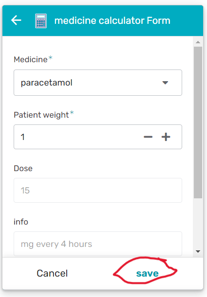

the app calculate very nice , but this save button i dont want after calculating to be saved

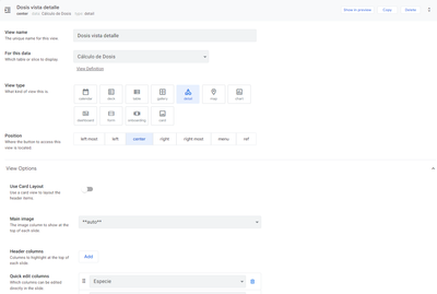

OK, convert that view to a detail view.
In the options that the detail view presents, you will find "Quick edit columns" add "Medicine" and "Patient weight"
Thank dear , still not working , in quick edit I cannot add "Medicine"
There is no any option to hide save button ?
There is no way to hide those buttons, unless you use the detail view with quick edit columns. If your medicine column is a Ref type, you shouldn't have a problem. If you can't see anything in the view then add a row containing just the ID from your google sheets document
