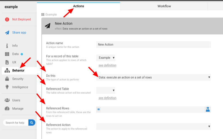

You could use an action of type Data: execute an action on a set of rows with a Referenced Table of the table on which the slice is based, a Referenced Rows expression that produces the keys of the rows in the slice, and a Referenced Action of the action you want applied to each row.
Note that youโ€™ll have to find somewhere to surface the button for this bulk action, and it cannot be an overlay on a deck, gallery, or table view, unfortunately.

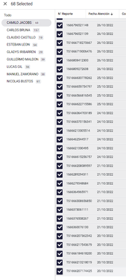

Lastimosamente no existe la opcion de selecionar todo en appsheet aun, una opcion con la cual yo me movilizo para ejecutar acciones sobre filas en la version de escritorio, es usar el Boton Shift + el cursor. Selecionas el primer registro y de forma posterior junto al boton presionado puedes desplazarte hasta el final y seleccionar todo.
y asi seleccionas todos los registros de 1 sola vez (SHIFT - CLICK).
Hi @BMACHERO may you please elaborate it ? I've clicked on SHIFT (on my Mac) select first record and move on the other records ... but the other records remains unselected ...
Thank you, @BMACHERO! @FaCe, first do a regular click on one checkbox. Then hold shift and click on another checkbox several rows away. All the checkboxes between the first and second checkboxes will get checked.
