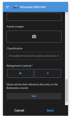

Now that my inter-table reference works, how can I retrieve the value of my "Final classification" field from my "Ebras" table in the "Classification" field from my "Building" table?
Ebras[Batiments].Ebras[Classification finale]
I put this formula but it doesn't work ๐Ÿ˜ž , Knowing that this field must be updated once the Ebras form has been completed
Could you you clarify whether you wish to populate the field in the Ebras table or in the "Bildings" table? It is somehow not clear from your description.
I want the "Classification" field of my "Building" table to be filled in automatically with the content of my "Final classification" field of my "Ebras" table.
Knowing that my application works this way: the user must first fill in the form of my "Building" table and then that of my "Ebras" table
Please take a look at dereference expressions.
Generally your expression will be [Ref Column Name in Ebras Table].[Classification]
