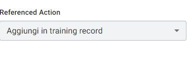

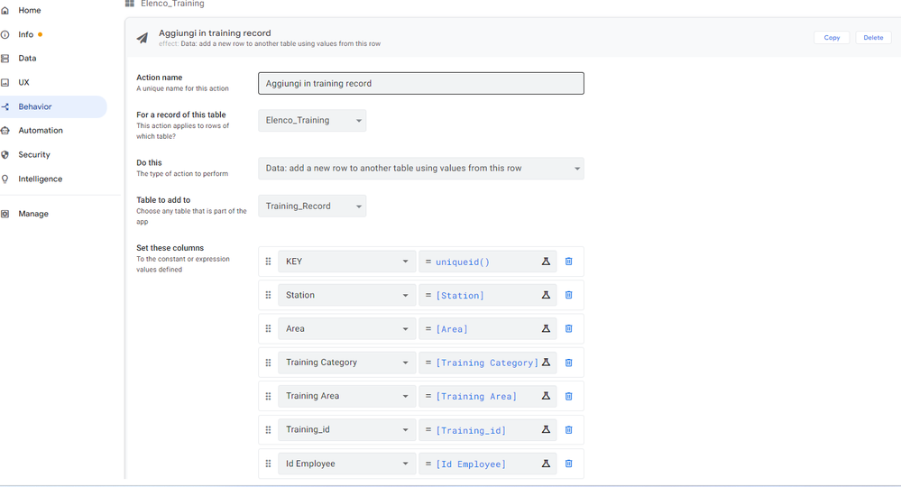

Can you show me what is now in the Referenced Rows Box. Then the action I was referring to is the "Aggiungi in Training Record" action that you put in the Referenced Action Box. That should be updating the area on each of the training rows to match the staff table. Can you show me what that looks like as well?
So now something strange happens, if I change the value of the AREA column in the "Staff" table, an entire page of data populates in the "Training Record" sheet but I don't want this, I want the value in the Area column to change Training List sheet, but I can't choose it in the Bot1.png
Let me explain better if I now modify the department of an employee in the STAFF table, now with the Bot active, I paste all the data of the employees who are in that department into the training record sheet
I have attached the screen of the action to keep track of all the changes made, which end up in the Training Record sheet which is a separate sheet
this is the screen of the action that sends me the changes made in the separate TRAining Record sheet1.png
So the Referenced Action Section lets you choose from the existing actions that exist on that table in the Behavior Menu. You will just need to add a new action there. You should see an add button at the top. If you click that you can add an action with "For a Record of this table" of "Elenco_training". Then "Do This" Should be "Data:set the values of some columns in this row". Then in "Set These columns" you will need to choose the Area column and put a formula of [id employee].[area].
Then you will go back to the bot and find the new action that you made and use that in referenced action rather than the Aggiungi in training record action.

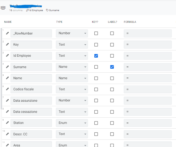

You will need to go to the Data tab and make Id Employee a reference to the staff table. It looks like in the original screenshot of the data table that you uploaded that how you had it set up. Sorry I did not notice that it had changed.
Also I would recommend making sure that the Key column is not the employee for the training table. You likely want to check the Key check box on the Key column in the training table. If you leave the key box checked for the the id employee column you will only be able to add one training record per employee.
Here is the screenshot of what it was, I would recommend changing it back to this. Note, you do not need to add the formulas back so I did include them in the screenshot in purpose. Screenshot 2024-04-13 at 4.40.32โ€ฏPM.png
