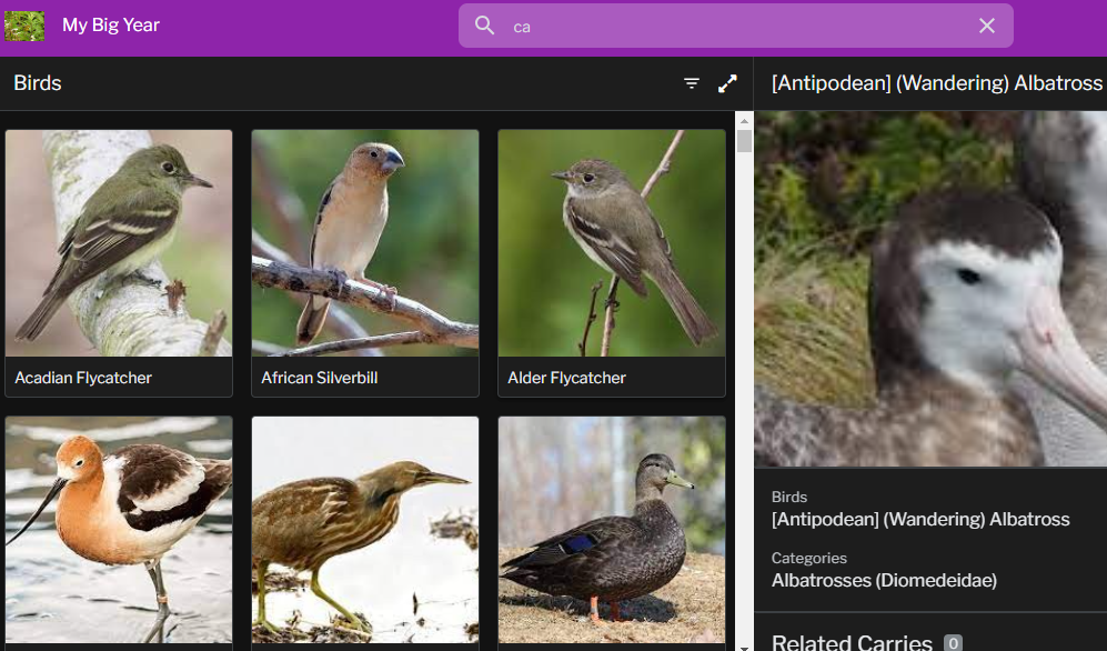

Here is an example. when I go to search it includes all birds that have the letters included in them. Is there a way to change it so that the results start with the letters?Screenshot 2024-03-08 141855.png
I'm afraid you are not able to change the behavior with the search functionality. You would need to create your own search functionality.
